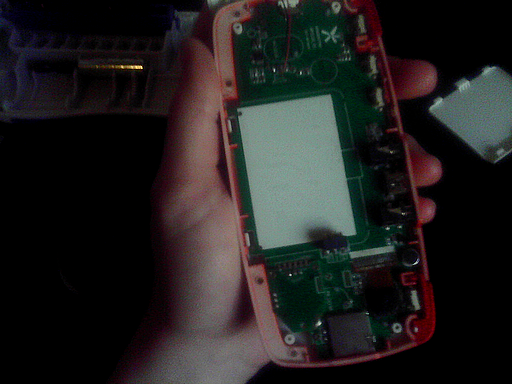

back of the circuit board. not terribly much going on here. above the speaker on the top you can see solder pins for the vibration module. also there are pins (and speaker holes in the case) for a second speaker, but i guess they screwed it for the "analog" stick. i dont think a second speaker the size of the original would fit in.

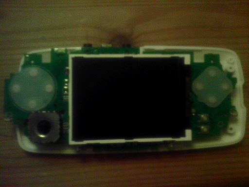

the front of the board, with lcd and rubber pads.

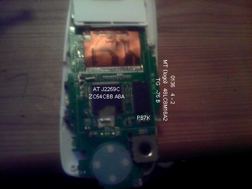

two of the chips.

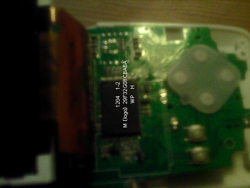

the third chip. i guess this is the flash memory.
