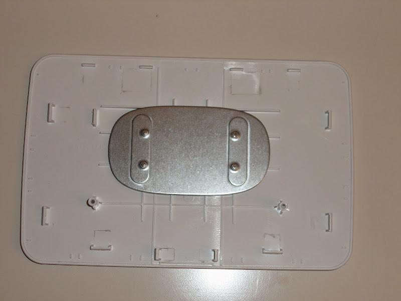

some photos.
Heatsink:
Internal MicroSD:

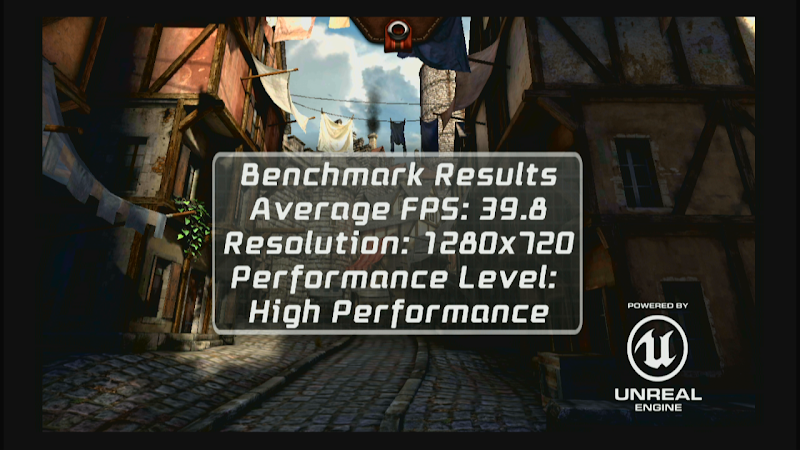

The device is a RK3188, but is limited to 1.4GHz. Without root, i can?t change governor (default is interactive) and antutu is reporting under 20000 points (GPD-G5A with skelrom is around 25000, using similar SoC).
Note: I?m running with screen at 720p
Epic Citadel result is 39.8fps, when with this SoC must be over 50fps

Nice pics and information you brought us, Deen0X. Just out of curiosity, you said that the device has the internal sd slot, and 5gb for the data partition. I'm supposing that these 5gb would be from the internal memory, and not from the sd card, right? So, the internal memory would be something around 8gb? Also, can you just replace this microsd card, and it works fine?
Deen0X
  • Posts: 1702
Re: GPD Mars Gamebox spotted @ Willgoo
« Reply #29 on: January 14, 2015, 12:24:20 am »
you can replace the SDCard, yes, in fact, there is fullfit of roms and games (creacked games) to be installed on the device.
i changed for another clean and there is no problem with this.
the main problem is data and app partition is the same, this mean, you really cannot use the microSD for installing app. in fact, you can use the device without any microSD on it, and you will be able on installing apps and data on the 5GB (realy are around 5.9GB).
this is the biggest problem. there is no way to configure the device to use microSD as sdcard for installing apps. the device always use the internal memory.
with root, we can bind the "android" directory to another directory in the microSD or even in an USB drive, for installing large game files from playstore. (similar to the Bind4Swap method i posted on my blog)
